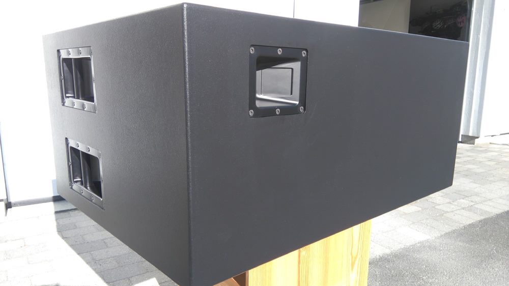

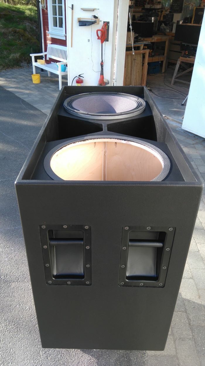

Lol the sticky No Compromises subwoofer is based on this design, as is mine (though I steal tricks from Evan's CD 218 and altered it considerably). Once you split the cabinet in half it's a very solid design.
Splitting the cabinet in half makes the cabinet considerably stiffer, and gives each driver it's own enclosure which helps in case of driver failure and more (there's a whole discussion in the other thread about this).
As far as my subs went, I made one with leftover ply and spare JBL 2241 drivers based on the design Luke came up with. Sound came out, and I've been meaning to created a revised version with a more massive port using a big-boy driver, but I haven't had the time, money, nor access to materials required. That and I've been lazy this semester outside of schoolwork.
whenever i got some time this year (around September or so), I'll do one proto with the center part little modified:
I just extend the tunnels on each opposize side (left upper E-c and right lower E-a) and the center brace (F) to the full depth of the cabinet, so it will be a diagonal separated and you'll have two separate "volumes" - this is my plan8)~:cool:~:cool:
... and MOOOOORE braces :D~:-D~:grin::D~:-D~:grin::D~:-D~:grin:
