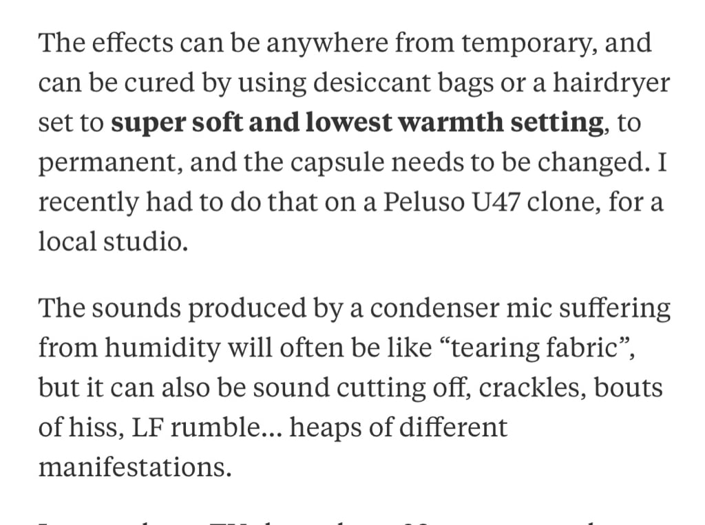

The only thing I am doing differently is I put condenser mics on the drums to mic the whole kit. That’s it.
This is what I read that gave me that conclusion on the humidity.

Again, neither humidity nor temperature contributed to this problem.
