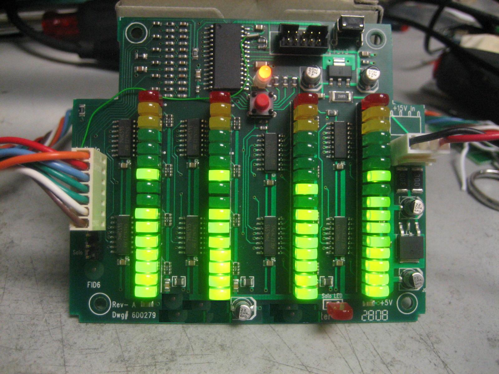

I know a little about the Prodesk meter since I designed the software for it. but I lost my copy of the schematic in a computer hard disk malfunction a few years ago and had no reason to request another copy from the lads.

Solo light is always on on the main metering. Nothing else is compromised and I can pfl all channels. The pfl light is located between the main metering for the center and mono mix LEDs.

If you are talking about the red LED on the bottom edge of the PCB (labelled solo), I would contact the APB website and ask to swap out the PCB. Don't tell them I sent you. :-)
