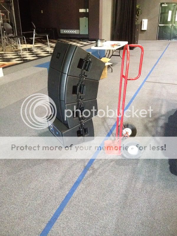

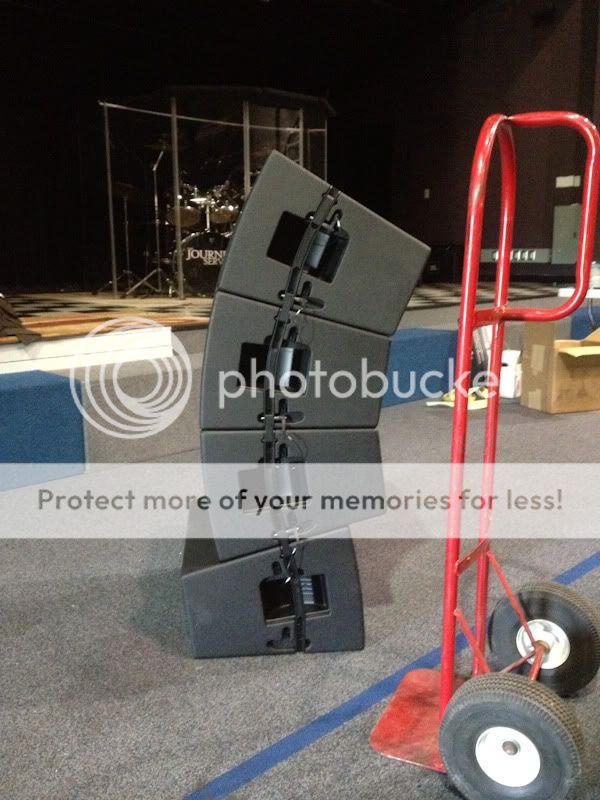

If you ever need to stack VRX's 3 tall but don't want the top one pointing at the ceiling you can spin a 4th one around backwards and the flyware will mate up. I did this for transporting them on a dolly, but I figured it would be useful for some folks here. I could see this being useful in a theatre or bleachers.
