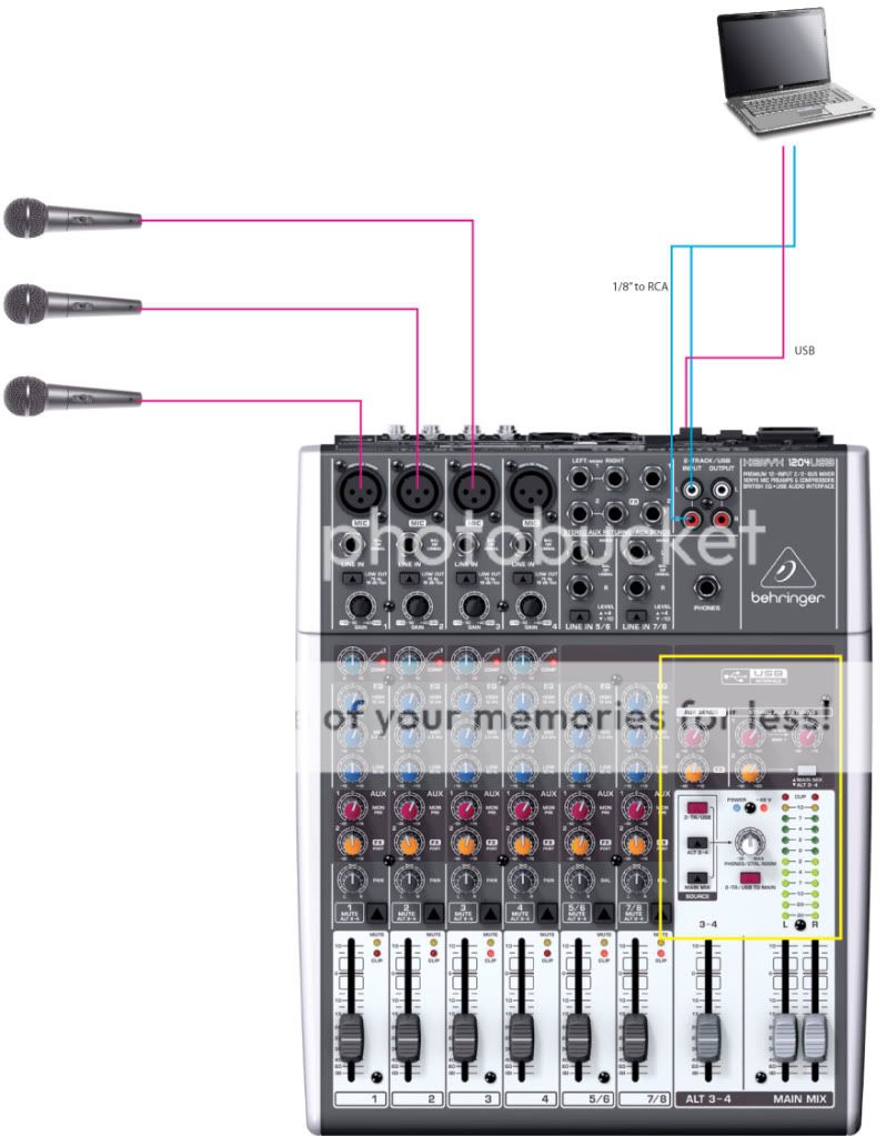

I've included a diagram of our set up. Maybe that will help us figure out what I'm doing wrong.
Mixer USB to laptop> recording app
Mixer > microphone x3
Laptop 1/8" to RCA on mixer*
*this is the part I am having trouble with.
I'm thinking that it's a matter of laptop configuration and button configuration on the mixer. I don't know what to set. The board recognized the music playing from the laptop (the level lights move) but I'm having trouble getting the music to come back out via the USB with the other sound.

Use Line In 5-6 for the laptop audio input. You will have to buy 1/4 to RCA adapters.
It looks like the 2-track input/output is somehow tied to the USB interface. No idea how that works, and there seems to be no buttons to assign it. Just use the regular channel strips and you'll be fine.

A quick search online suggests that neither the USB or 2-TR inputs can be routed to the USB output. You can apparently monitor the audio from the computer via the Control Room outputs and send the mix, minus the audio from the computer, to the computer by selecting the 2-TR/USB to Control Room red button and also deselect the 2-TR/USB To Main red button. Using the analog output of the computer and the stereo inputs on the mixer may get around this but as Mike noted, that may also create a feedback loop.
The stereo inputs also have no gain controls, just the faders, and are balanced inputs, so that means you may have to watch the levels coming in and try to get reasonable incoming levels by adjusting the source (computer, CD, etc.) output levels.
