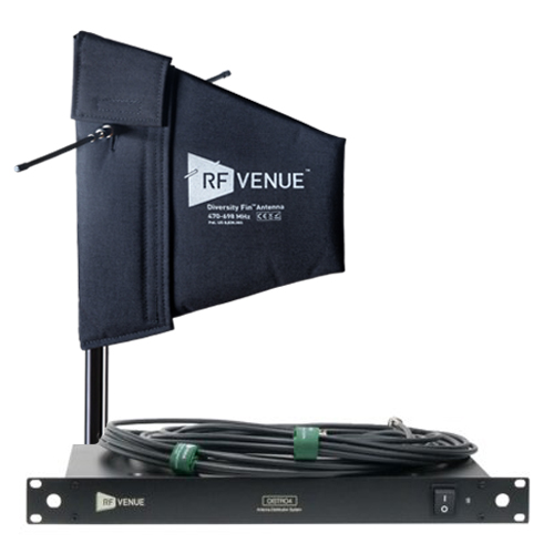

Asher, you may look into RF Venue products.
They work equally well for Sennheiser and SHURE receivers and will power them as well. The Diversity Fin antenna is usually less expensive than two of the aforementioned antennas and outperforms the stock antennas. Make sure that you buy NEW cabling for all of your RF connections. The cabling is AS important as the other gear in the RF signal chain. You can usually buy this stuff at Sweetwater Sound as well as other retailers.
