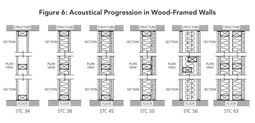

It's a stud wall, 5 1/2 inch studs between townhouse units, I'm gonna take off the drywall and put 1 1/4, maybe it's 1 3/4 MDF and pieces of 1 3/4 solid core doors between the studs ( I work at a door company). I think the question is I would expect to want to fit the MDF between the studs as good as possible. That might not be what I want to do. I might want to leave an 1/8 or 1/4 gap and fill that with acoustic caulk. Green glue on the side of the MDF facing the other unit. Any other suggestions for improvements? The drywall will go back onto the stud, use green glue there I'd think.

From your post, it sound like you are trying to increase isolation between spaces. To do this, you need to eliminate paths for sound to travel between those spaces. This is normally done by a combination of eliminating air paths, eliminating vibration paths, and adding attenuation (absorption) to the paths that remain. There's also things like local building codes and fire codes that need to be respected, especially since it appears you're working on the wall between units.
For commercial office buildings, it's pretty common to see interior walls filled with fiberglass insulation to increase the sound isolation between adjacent rooms, but there are certainly other techniques that are also used where high isolation is required.
Even if you can build an isolating wall, you must consider flanking (structure-borne) noise first as this is very difficult to treat and can negate any wall improvements particularly regarding impact noise. As Rob suggests, it's not as simple as adding a bit of mass and there is very good information online showing attenuation values of different constructions, which can often be counter intuitive! Although thick wood feels like a lot of mass it is trifling compared with masonry construction - my 17C stone walls are up to 200lb/sq.ft - so absorption and depth of lightweight walls becomes a critical design factor.
You've not said what the purpose of the project is? Stopping people next door's voices being recorded, or stopping your drum kit getting through to them, or what? Many architect designed between property solutions are pretty much limited to preventing speech. Depending on the floor and ceiling, a new panel with an air gap on a fairly lightweight stud system could work for some things, but MDF is a favourite of mine because it is pretty effective, string and can be easily fixed. It's heavy though, if that matters? I'm absolutely NOT a green glue fan, and depending on what you are trying to reduce, the sheet material could be thickened to produce a much cheaper reduction in transmission. What are you trying to cure?

Mass is better than nothing, but you will be disappointed with simply plugging up the gaps with solid wood. Mass Law states that attenuation is only approximately 5db for every doubling of wall mass for a single skin wall. Any partition wall with a mechanical link (eg. plasterboard nailed each side of common studs) will be difficult to improve, and an entirely separate wall loosely coupled only to the side walls, floor, and ceiling only should be considered a minimum first step. You can then add as many layers of MDF as you like to your new wall (perhaps with the final layer on resilient bar) and partially fill the void with Rockwool - there must be an air gap with between it and the existing wall. Mechanical isolation is paramount! This construction can typically achieve about 55dB overall noise reduction.
