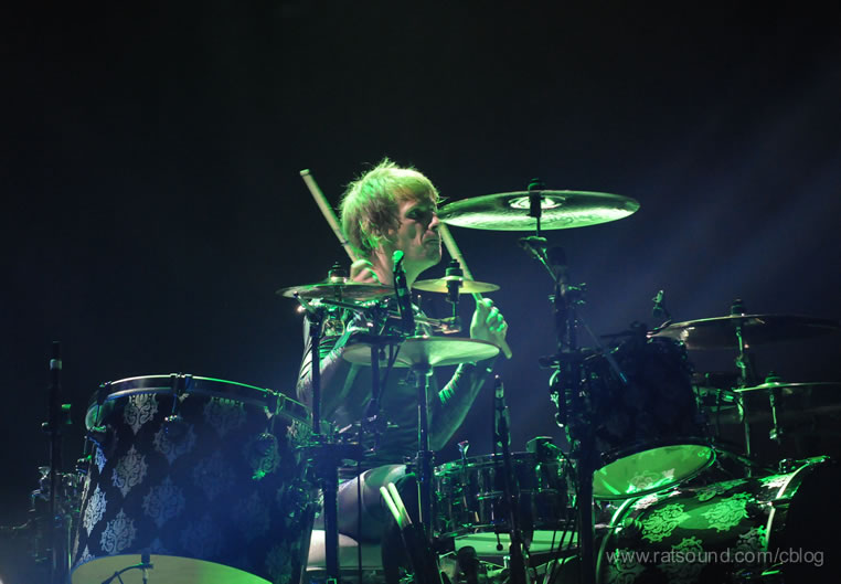

Muse is a great example of people using mic'ing underneath for cymbals. Here's a shot that Dave Rat took of their drummer rocking out back in October. The hat isn't under mic'ed, but the others are, and I wouldn't be surprised if it has been before.
