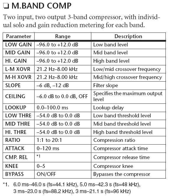

What is SLOPE (never mind - I slope is the slope of the crossover filters) and CEILING for? I can't imagine why this is not all explained in a manual somewhere, but google can't find it.
Hi again Harry.
I don't have a link as I have the actual manual here, but check out page 329 of the DM 2000v2 manual :)

Sorry I see nothing there to indicate that it's different in different consoles but I don't argue it is or is not the same. Just dont see where it says that. Also funny you posted a link to something I commented on. Like I said been all over google.

"PM1D (V1.6 or later), PM5D, M7CL, LS9, and DM/0 series has a program of multi-band dynamics in EFFECT unit (M.Band Dyna.).
PM5D, M7CL, and LS9 has multi-band compressor program also. This is little simplified version and easier to use. (M.Band Comp)"
You're right, it just highlights the difference between M.band dyna and M.band comp! Out of those 5 I only have the 2 that only have M.dyna, so I guess I focused more on that part.
