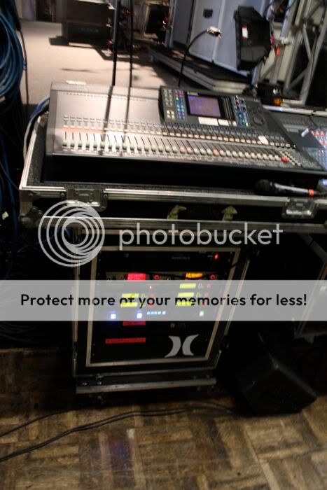

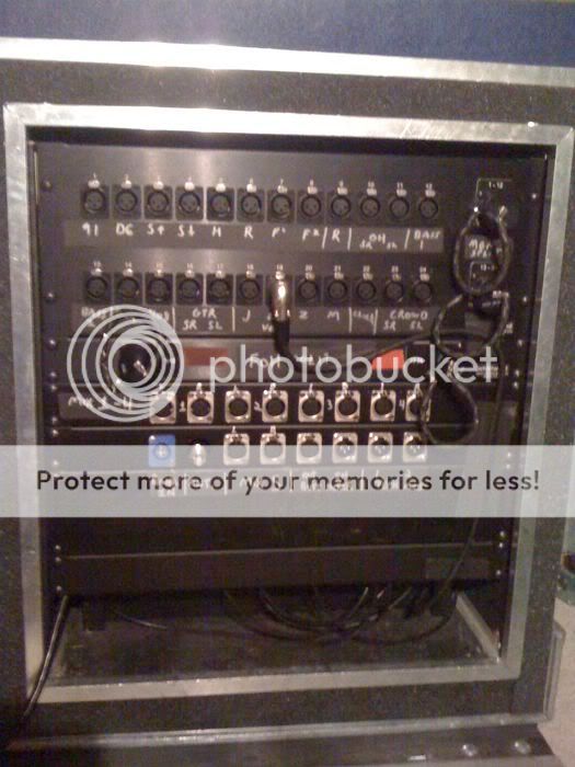

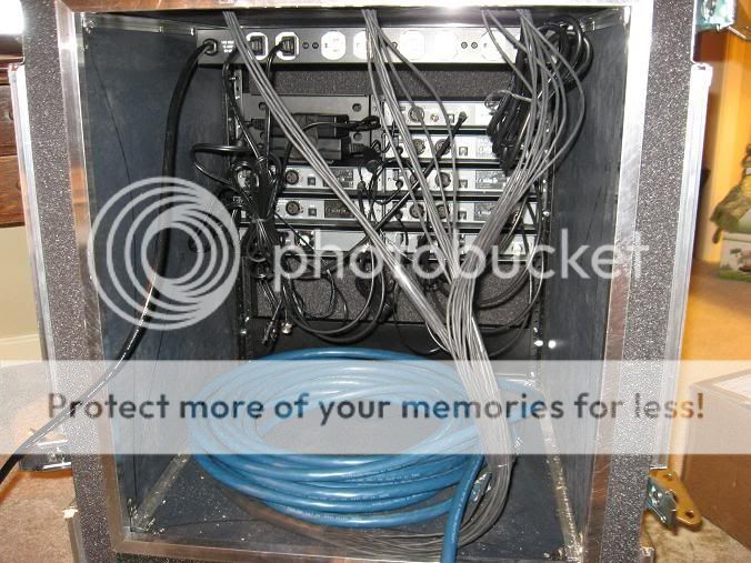

Here's some pictures of the rig as well(sorry for the average quality):

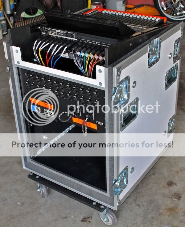

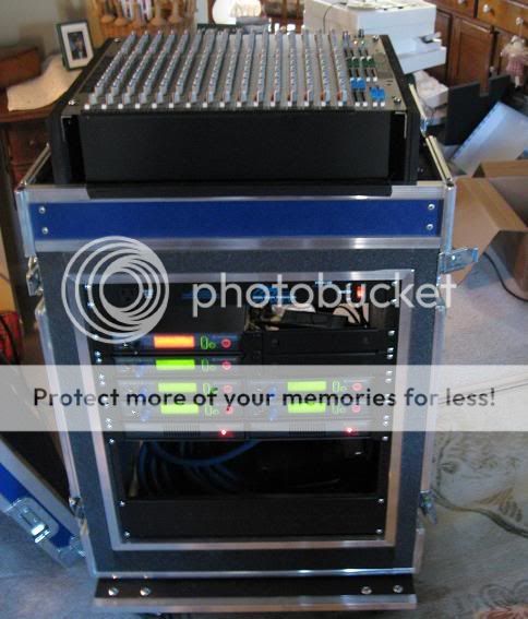

And here's our old system(very similar to the basic setup):
