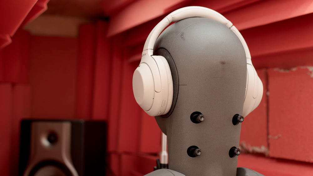

This website has some great data on almost 500 different types of phones, probably a better place to look than to an old deaf guy who has used the same phones forever ;^).
They do some extensive testing, you should be able to get some comparative "bang for the buck" information there.
