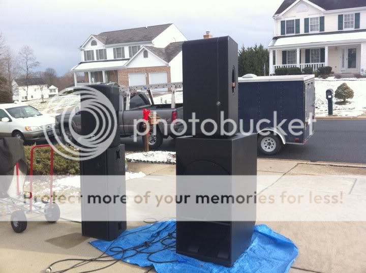

Well, as some of you guys know, I picked up a ''small'' self powered PA to handle my local shows. My goals with this system were easy ins & outs, lightweight, loud and good sounding.
I explored many options. Everything Guitar Center carried, some recommendations here from the LAB and even some older powered stuff no longer in production. The Mackie HD series caught my eye early on, and I was skeptical at best. Mackie hasn't had the best track record, and their powered speakers seemed to have fallen behind the times.
I had a solid day of demoing gear at Guitar Center. We used my tracks to listen to with nothing in line other then a Mackie Onyx. I listened to the JBL and QSC offerings, as well as a few other powered boxes. The Mackie was the only powered speaker at Guitar Center that wasn't a toy. I also listened to the EV ZX5a, and RCF offerings. Neither impressed me.
So, I settled for a small Mackie rig of 2 HD1531 tops, and 2 HD1801 subs.
The form factor of the cabs are great. The HD1531 is way smaller then the QSC and JBL boxes, and looks a lot more ''pro.'' The HD1801 sub is a cube, and easy enough to move. I can get the HD1531 & 1801 into my truck alone, but I need another person to get the tops on a pole. Build quality is top notch too. They're made from real wood, and have a tough finish on them. They've got a bunch of fly points as well.

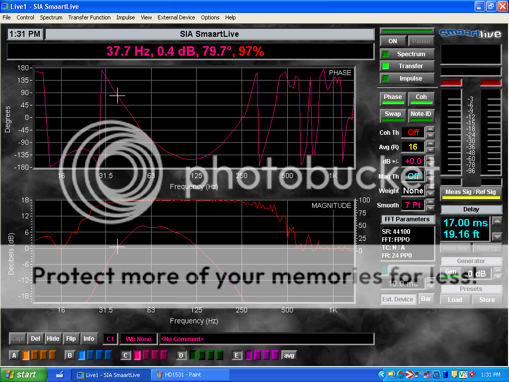

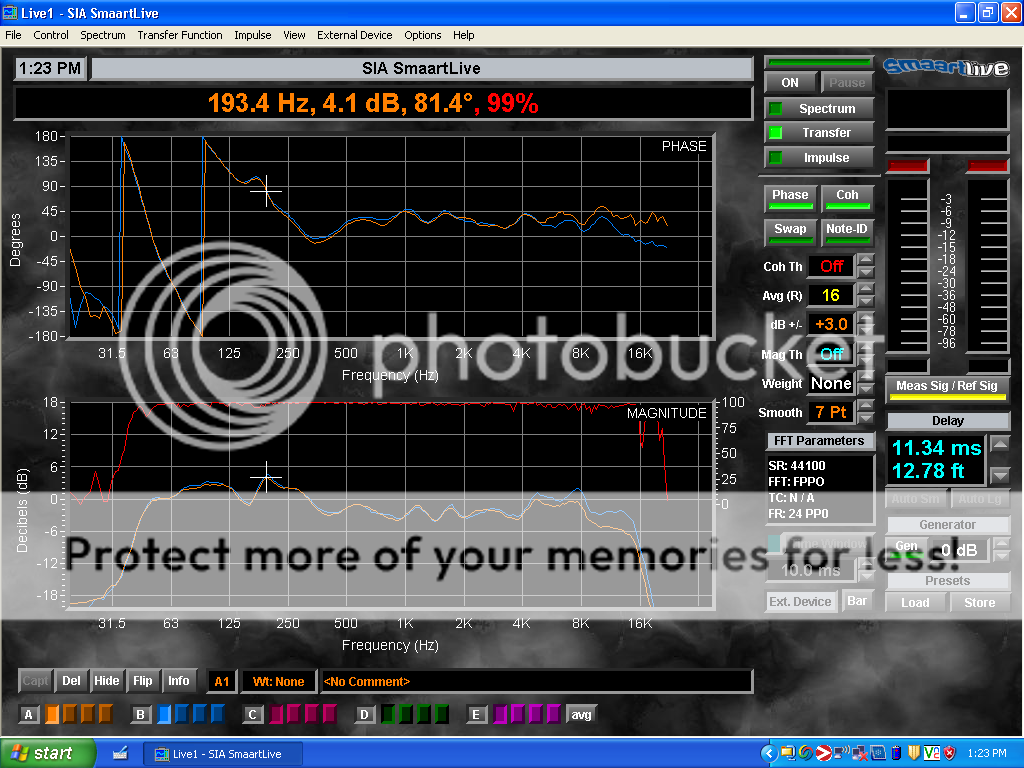

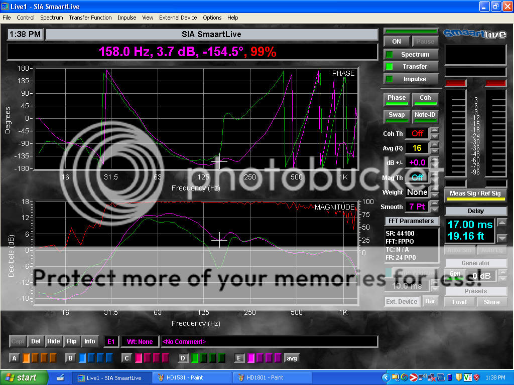

So, let's get on to the testing. First, some SMAART traces I took today. It should be noted that all measurements were in the ground plane.
HD1531:
The Orange trace is with the EQ in the flat position. The blue track was with the hi-shelf on the box turned to +3.
HD1801:
Full system:
I didn't really care too much about the full range response, but rather how the boxes played together at the crossover point. The green trace is with both boxes running full range. There was a noticeable dip at 160hz, as well as the overall ''fullness'' of the LF. But, when the top was high passed via the 1801's output, things smoothed way out and sounded much better(purple).

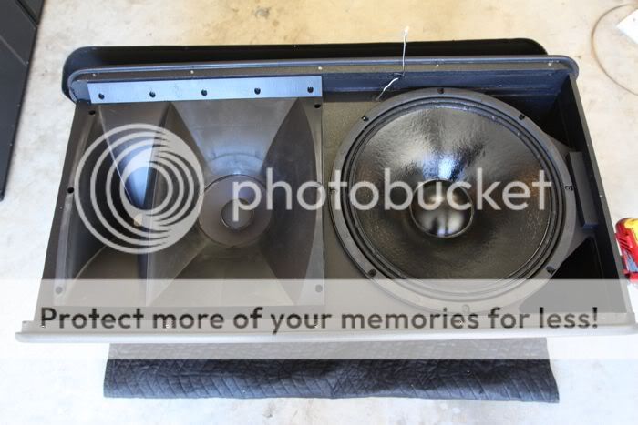

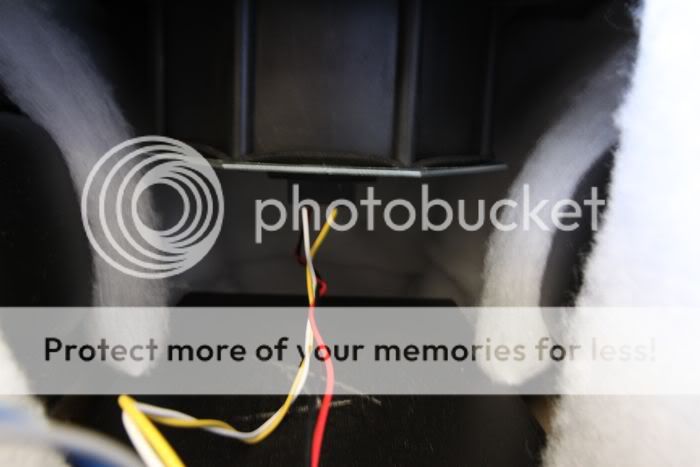

I was overwhelmed with the urge to rip into these Mackie's today, so here you have it.
First, is the HD1531:
Mackie did a good job packing a lot into a little space.

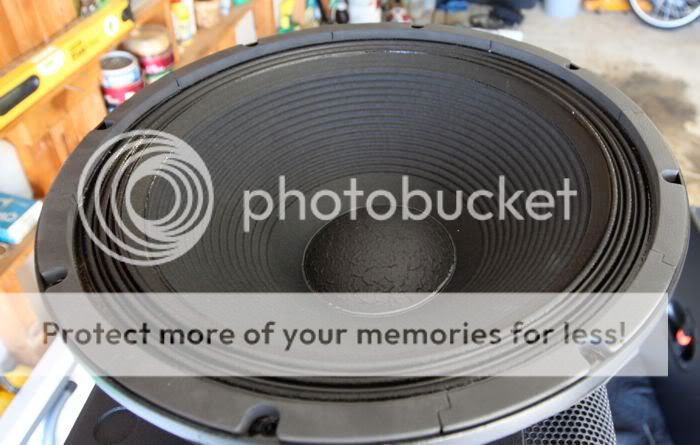

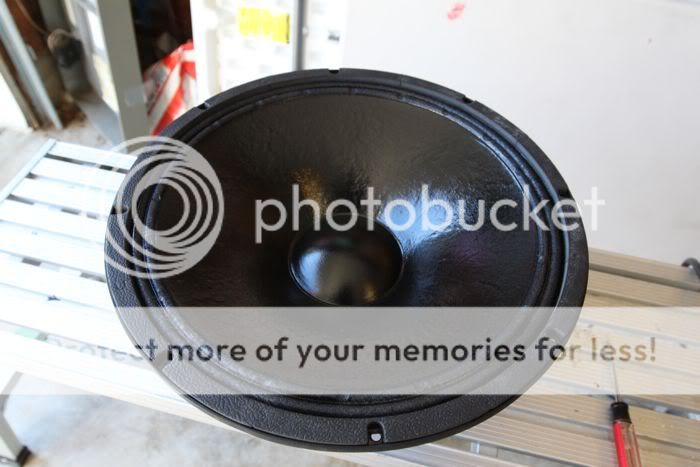

I pulled the 15 out, and was surprised to see the amp in a completely different chamber than the drivers. Cool design feature. Lots of bracing inside. The mid range driver was in a sealed chamber, separate from the rest of the drivers. All of the drivers were neo. I didn't want to rip into the MF/HF section, as it just seemed like too much work for today. Maybe next time!
The 15'' was a nice lightweight neo driver. No idea who makes it though.

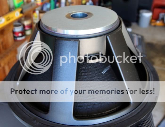

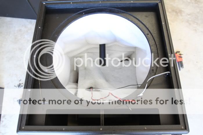

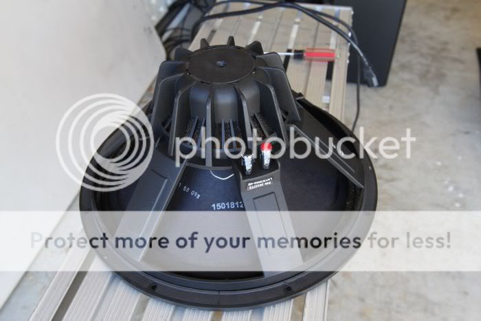

And, the HD1801:
The 18'' was not a neo driver though. It was a heavy sucker, probably half the weight of the cab! Again, a nice build with plenty of bracing inside. Much smaller port then I was expecting though.

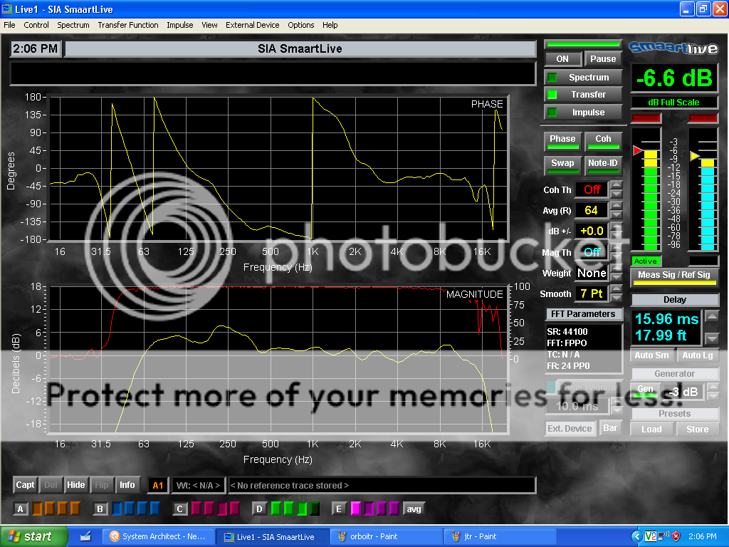

Before I start any comparisons, here's what the ZX5A looks like with no processing:
I probably could have smoothed out the phase response a little more, but it was cold and I wanted to be done at this point.
