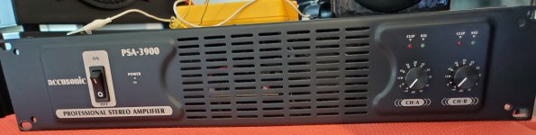

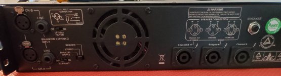

I've got 4 Accusonic/Show amps (2 x PSA-3900, 2 x PSA-31500), all four of them were working in all modes (stereo, bridged, parallel/mono). The following day I was testing them out and all of a sudden all four amps only work in bridged mode but not stereo mode or parallel/mono mode. Has anyone ever seen or heard of this before? I'm testing each one on their own so it shouldn't be a power supply/voltage drop issue. The only thing the four of them had in common is that they were all plugged into the same power bar running through a DBX Driverack PA2. So I tried them individually on a different power bar and a different outlet with a direct signal to each amp, bypassing the PA2 and still have the same issue. What would cause 4 individual amps to all lose stereo mode at the same time? I have verified the following during my trouble shooting:
  • speaker is working: used multiple working speakers with no luck
  • Speakon cable is working: wired correctly to pins 1+/1-
  • signal is working: balanced signal being sent via XLR
  • power supply is working: breaker has been reset
  • breakers on all amps are all reset
  • clip limit is on but i've tried it off as well with no luck
  • 30hz filter is off but i've tried it on as well with no luck
  • bridged mode: signal showing on both channels when channel A pot is used, as designed. sound is being sent to bridged output channel.
  • stereo mode: Signal is showing on both channels A and B. sound is not being sent to output channels A or B.
  • parallel(mono) mode: Signal is showing on channel A as designed. sound is not being sent to output channels A or B.
Here's a link to an older version of the amp that had binding posts. my version has 3 speakon terminals only 1 stereo pair and a 3rd for bridged mode. https://www.manualslib.com/download/1536675/Show-Psa-Series.html
pics of front and back:
There's probably an obvious reason but I don't know what I'm missing.

One suggestion is that bridged mode doesn't remove signal from the 1- pin. It says to use 1+2+ for bridged but doesn't say what happens to 1- when it goes bridged mode. Perhaps there is still signal there even in bridged mode.

Hi Joey -
The text is bold is correct for most power amps. As the channel negative output is not physically disconnected, there is typically a signal present.

Ok so that would explain why bridged still works but I never found out why stereo stopped working. It has been fine since the initial 2 occurances that resolved itself.
