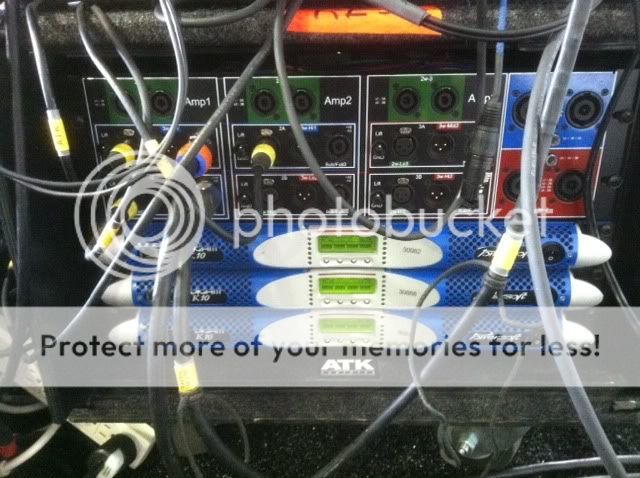

Here is a picture of the little ATK racks I had from a while ago, I am still trying to find a side and rear shot of the racks.
If I get a chance I will post up some pics later of the rack I built for our shop. They are lab gruppen racks but it will give you some ideas with the I/O stuff.
