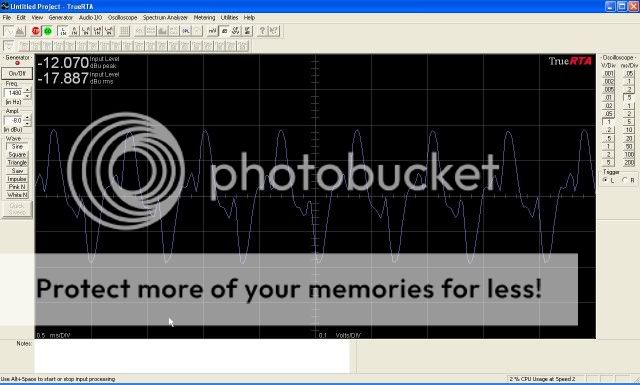

On the bench, fed from a sine generator I noticed that the buzz only appears at some frequencies and only starts at a certain level.
I used TrueRTA scope function to view the output of the driver as picked up by a measurement mic.
As the signal level was increased (at the offending frequencies) the waveform switched from nice and 'pure' sine, to an ugly and distorted wave.
This is what it looked (and sounds…) like above a certain (low) level:

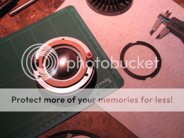

Here is the original (pressed) gasket:

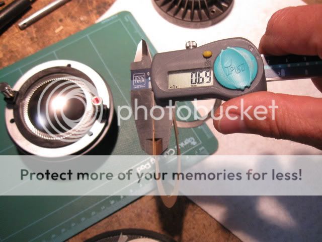

This is the new one:

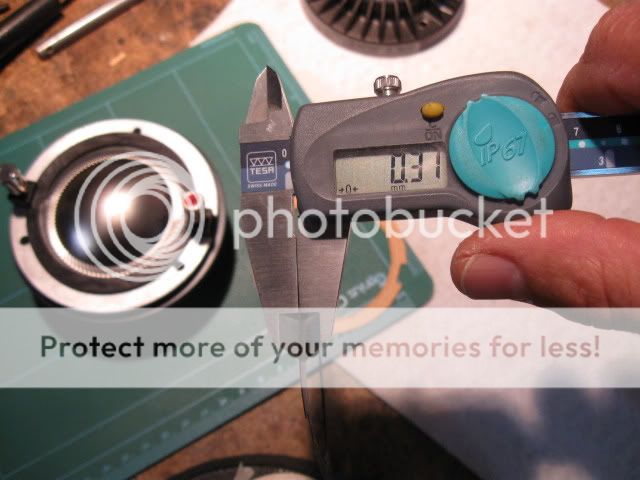

Here in place, before closing the back cover:
