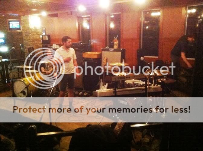

I once did a gig, with 2 bands set up on the dancefloor. A drum kit was set up in each corner and they took turns doing one song each, trading off. Both bands use the same vocal mics and monitors. Amps were places in the middle, just kept it simple, and mic'd the kick and snares.
Real last minute idea that worked out pretty good!
