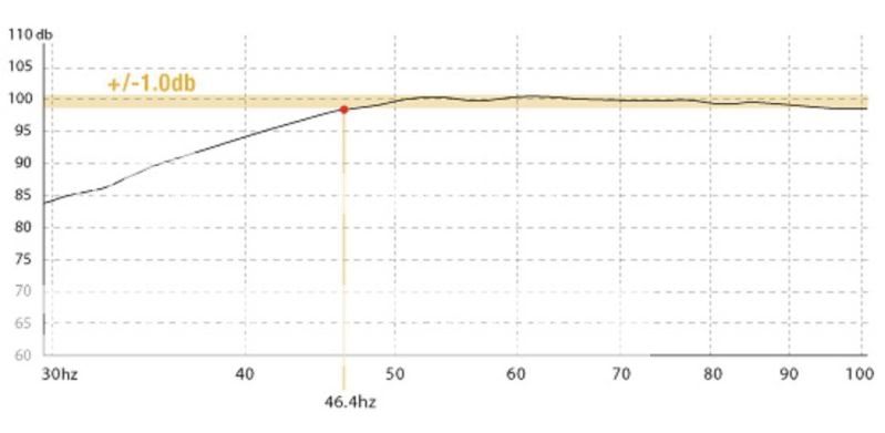

I think you have it the other way around. There are only a "hand full" of people out there that didn't enjoy it. The Growlers debut at a Prosoundweb shootout back in 2007 there was a couple of dozen people that heard and enjoyed the Growler. Most everyone that has heard a properly operating, properly setup Growler has enjoyed them. Side by side tests conducted by forum meets have proving the Growler has more output and lower distortion within the horns operating rate than the SRX718. The advantage of the fold horn subwoofers is throw and lower distortion. The disadvantage of the horn is increased distortion below the horns operating range however the lower in frequency the less sensitive humans are to tonality. This means lower distortion where we are more sensitive but more distortion where we are less sensitive.
Some people may of dismissed the Growler simply because they didn't full read or understand the specs. The original Growler was +/-1db 46hz-110hz:
However, it had that same -10db as its competitors such as the SRX718 (35hz) and it you look at a +/-3db window (6db) the Growler's lowend cut off was 39hz.

The side by side tests I have seen results from show the Growler and the JBL SRX718 to be remarkably similar in terms of output and distortion, with the Growler's distortion, as you mention, increasing rapidly below the horn cut-off of 46 Hz.
As far as us being less sensitive to low frequency distortion, not true.
Low frequency distortion results in upper harmonics not present in the original signal, for instance a 30 Hz tone will have harmonics at 60, 90, 120, 150 Hz.
Our ear is far more sensitive to the upper harmonics, so the 60 Hz harmonic of 30 Hz the Growler generates with about 300 watts (just over 100% distortion) would sound almost twice as loud as the fundamental tone.
