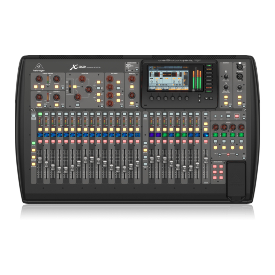

Well the x32 shit itself at the show today. Luckily had the Ls9 sitting in the truck. Anyway, board shut off last weekend, and wouldn't turn on. Came back for the show, lasted the show, then it wouldn't even turn on today. The lights that are on would be the backlit buttons on the side of the screen, and the arrows. Nothing else
. Only other thing working on the console is the fan on the psu. any suggestions though as to the problem? I'm thinking power supply, but second opinions are always good.
edit: random LEDs flash throughout the board when power switch is turned on. But nothing after that except lit buttons by home screen.

. Only other thing working on the console is the fan on the psu. Had it apart. Everything's connected inside (Really bad build quality though, some stuff is literally held on with electrical tape) any suggestions though as to the problem? I'm thinking power supply, but second opinions are always good.
PSU appears likely.

That sounds like one of the rails in the PSU has failed. Ordinarily, I'd suggest checking warranty status to see if the unit can go back to the manufacturer, but in this case, you've likely voided your warranty be opening the thing up.

Power supply cooked I think., no loose ribbon cables. Couldn't reload firmware. problem with road case actually. It's out for warranty repair. I'll know when it gets back to the shop. Actually..... As a warning to everyone that has an x32. Beware of your gator cases. SOME of them have foam throughout the entire underside of the board. It's really soft too. After a while the rubber feet on the board dig into it causing the bottom of the console to sit on it..... Well the power supply fan is on the bottom of the console. Go figure right? It blocks the airflow to it.

Can't just blame it on Gator- almost all cases have foam on the bottom. Power supply fan on the bottom sounds like it was designed by someone who never actually used a sound board out of the lab!

The fan is where it is, it's up to the case manufacturer and the user to make a case/modify to fit the mixer.

I used some strips of material (1/4" plywood would be fine... 2"x12" approx) that sits under the feet of the X32 in the Gator case. With more area to press down the feet don't sink into the case foam and so the PS doesn't get starved of air.
I was thinking I read newer Gator cases addressed this design flaw on their own somewhere.... And the design flaw is Gator's not the X32's...

Did if the same thing basically to ours after this happened. And yes they did address the issue at some point. The newer cases have much firmer foam in them, and it is only about a 6x6 pad under each foot. Nothing under the rest of the console.
