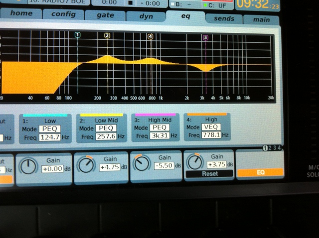

This is the channel EQ on the lead vocal channel:

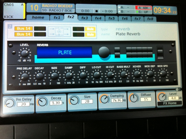

Quite standard for vocals, nothing specail. Now for the vocal reverb. Personally, I don't like reverb very much on vocals, but the vocals sounded way to upfront with the local pa system, that I had the feeling, they need to go back into the mix a bit.
So I dailed in a bit of this:
Short reveb time, and a serious PreDelay, which lets the transients of the words without reverb. This helps to keep up the vocals definition. Concerning FX, I always use lot's of hi and low cut. When I got the time, I adjust the high cut like this: Every singer has more or less a specific "SSSS-Sound Frequency". Normally between 6-9kHz. During soundcheck, I set up one very narrow EQ band and sweep through the lead vocals, to find this frequency. Than I use this frequency as cut off (hi cut) frequency for my reverb and delay fx. Otherwise, the FX will even enhance the SSS-sounds. Here is my dealy setting:

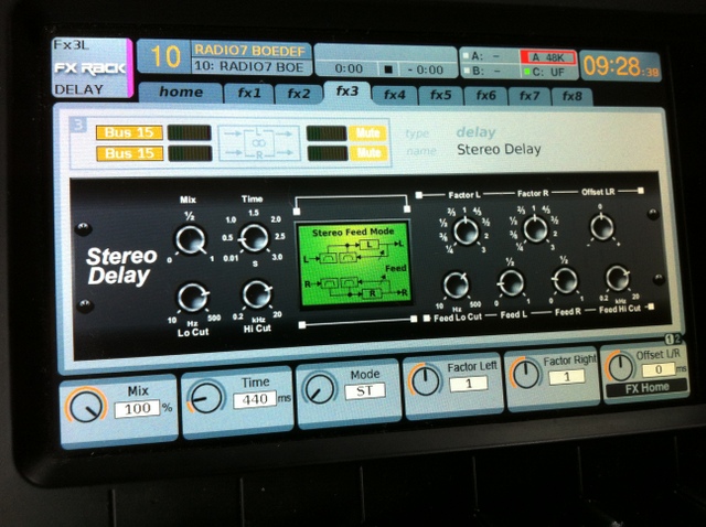

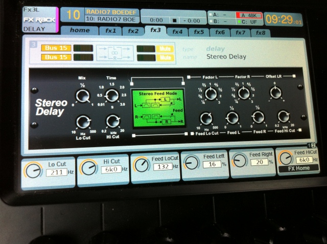

and:
Quite dramatic hi&lo cuts. This keeps the Delay sound more in the "back" of the mix and the spillover from cymbals is lower in volume as well in the mix. I used slightly different Feedback times for L&R. This enhances just a tiny bit the depth of the delay fx.

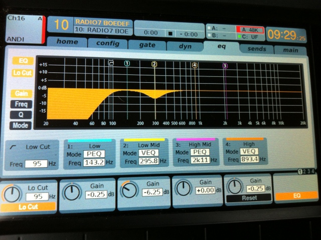

One thing about EQ in general. In a dense mix, it is sometimes hard to find a "parking lot" for all signals. One thing the helps me, is to create space with EQ. This is one topic in the FabFilter EQ tutorial as well. One example. This is the EQ on the keyboards:
You can see a dip in the low mid area.

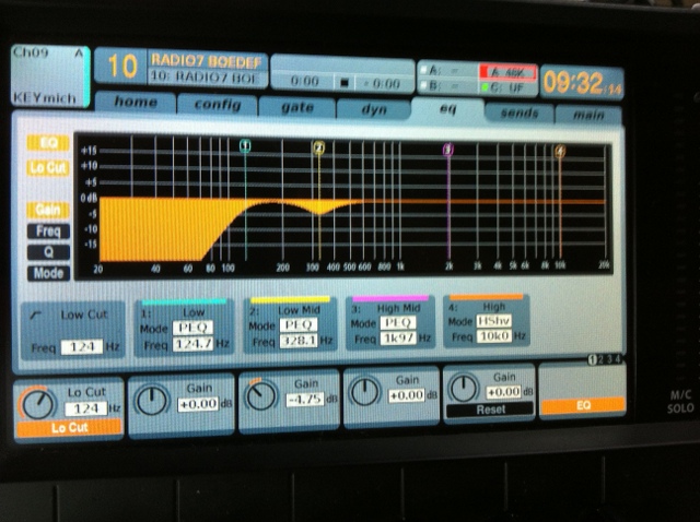

On the guitar is quite the opposite.
Now I had space to feature the low mids on the guitar.
This technique works really good for the "problem area" kick drum & bass as well!
