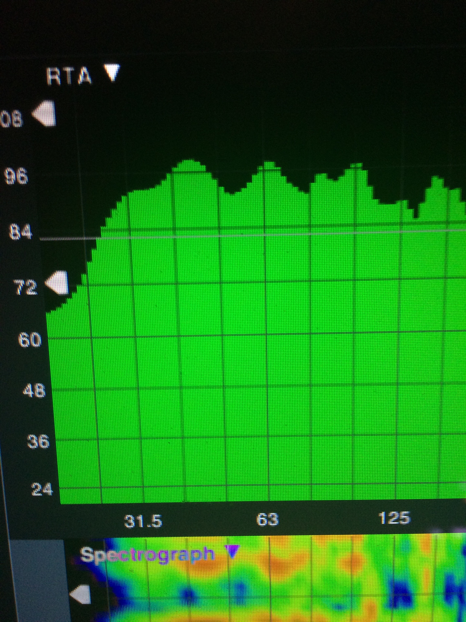

Your boxes look great and measure very well. I think you have selected an excellent compromise with this design - I have some thing similar but it uses 18 sounds 18NLW9000's - FWIW I just love them :-)

It looks like it is -3 around 40Hz? Do you notice anything missing below that point?
Measured indoors in the warehouse it's 35-100hz +/- 3dB, 30-100hz +/- 6 dB.
Not noticed any lack of content below 40hz, powered by a K20 it emptied a shelf of DPA mics onto the floor :P
