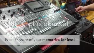

Ran our third show tonight getting familiar with the board. Noticed the monitors are not as loud as they used to be we maxed bus slider and the analog knob and they just weren't enough. I patched in eqs and didn't boost the gain to them should?
Agreed. I wasnt sure if it was just me...

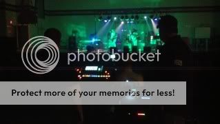

Another gig update and first casualties!
Last friday did a gig with my X32 and two S16 in a small club (300pax). Two bands, just the basic stuff. But this time I had some "serious flaws".
When I bought my X32 case from Thomann, I orderd this mixerstand at once-->
Millenium MX-1000 - Thomann UK Cyberstore
After 30 gigs, this thing has finally died! Stay away from it...it sucks.
First I had to replace one stopper with a screw, because it just broke off.
On this gig, both wing bolts broke off-->
But this was not the first victim this night. When I arrived at the venue, I was short of time. The lighting guy wasn't there at this time, and he was in charge to bring some yellow jackets as cable lead through (DMX and AES50). So I layed my AES50 on the ground and connected the X32 with S-16 and told the few people to watch out for the cat5 cable. You know what happend. One guy stepped over the cable and the AES50 connector inside the X32 was instantly broken! I used a cable with no Neutrik Ethernetplug...so it broke the plastic inside the AES50 socket of the desk:-(
Thankfully, the X32 has two AES50 ports! So I went with AES50 port B and was ready to go, when doors opened. Sadly enough, my desk went the next day to England with the "WBTBWB" Tour. I hope these guys don't run into the same unlikely problem.
On the other hand, the show went fine. One band was mixed by a friend of mine, who never mixed on a X32 before. He got 5 minutes of instructions from me and he had a blast. Seems that the audience liked the sound as well:-)
I had again the new KME hybrid system with me...this PA is awesome!
